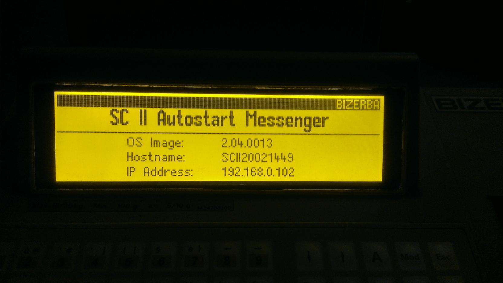

    I've bought a second hand Bizerba SC II 800 and when I start it up, it just give this message ( image attached below ) and just stays there.
    what shold I do ?
    thanks a lot

  • Thank you for your reply, I live in Belgium Brussels and unfortunately I don't have the contact informations of the previous owner .
    I've tried pressing the enter key and a lot of other keys but no reaction ( btw I don't hear any bip when I press the buttons). I tried weighing too but nothing.
    I removed the battery from the motherboard in attempt to make it forget the settings but it didn't work. I found an SD card attached to the motherboard, I pluged it to mu pc and I found some system files, nothing special.
    I don't know what else to do !
  • When you told me that when you press the keys and do not hear a bleep that should be ignored because the bleep can be turned on or off in the menu!!
    I looked up what the message could mean and this is what I found!!!
    I checked the I.P. address and it explained that this is a common IP address for a modem.
    Then I looked up the host in relation to your scale.
    It seems quite likely that this scale may have the Bizerba Windows CWS operating system installed.
    This Bizerba windows CWS operating system enables you to communicate with the scale via a modem.
    It enables you to create a label on a computer and send it to the scale and also produce audit and management reports.
    It may be possible that inside your scale there will be labels that have been created already; each one having a PLU NUMBER.
    ANYHOW TRY THIS!!
    PRESS MOD, THEN PRESS ENTER, AND SEE WHAT HAPPENS???
  • I tried what you said but it didn't work, I also tried many other combinations but nothing. normally, these scales have a reset combination key ( at least Mettler Toledo), I searched everywhere on the web but there's very little documentation.
    I will try to plug it to my pc with an ethernet cable and go to that ip address, if you have the software that will be terrific!
  • Sorry I should have said press MOD KEY, THEN THE ENTER KEY (BLACK BENT ARROW KEY) THEN USING THE BLACK NUMBER KEYS, TYPE 112

  • unfortunately, the combinations you proposed did nothing, the scale doesn't react at all.
    I'll continue to search for a solution though. maybe if I can find where the settings are stored on the motherboard, I can short circuit it just to make it forget (like a pc bios) but I'm not sure if it's possible.
    thank you very much for your help :)

    I pluged it to an ethernet port on my pc and tried to go to that ip address, the led on the motherboard start to blink when I hit enter, but nothing come in the browser ( tried many browsers).
    I've go ahead and extracted the files on the SD card attached to the motherboard, maybe it'll come in handy to someone in the future.
